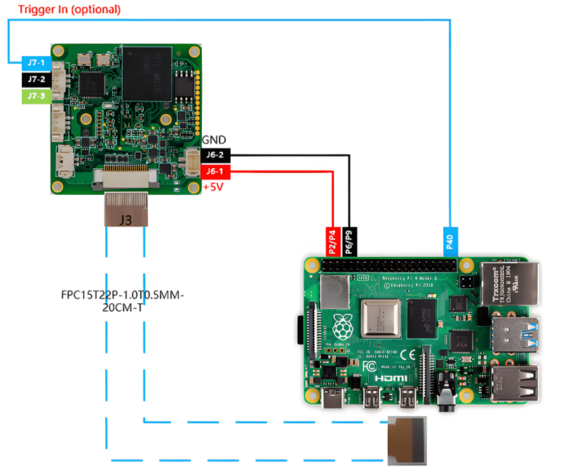

====The connection method between the GX series cameras and the 15-pin interface Raspberry Pi====
[[File:Gx to raspberry4 .png|alt=GX Camera to RaspberryPi4|center|thumb|800x800px|GX Camera to RaspberryPi4]]

2 Hardware Preparation and Installation
The GX-series cameras utilize a Raspberry Pi-compatible 22-pin interface but require an independent 5 V DC power supply.
2.1 The connection method of GX series cameras with 22-pin interface Raspberry Pi
GX Camera to RaspberryPi5
2.2 The connection method between the GX series cameras and the 15-pin interface Raspberry Pi
