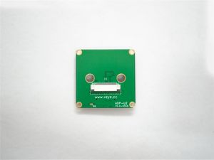

| + | [[File:ADP-U2 004.jpg|thumb|ADP-U2 004]] | ||
