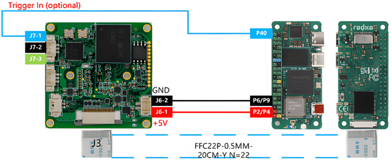

2.1 Connection of other GX series camera and Radxa ZERO 3W/3E
The two are connected using 0.5 mm pitch*22pin FFC cable with opposite-side contacts. The cable must be inserted with the silver contacts facing outside.
Radxa Zero 3W/3E connect to GX series camera
