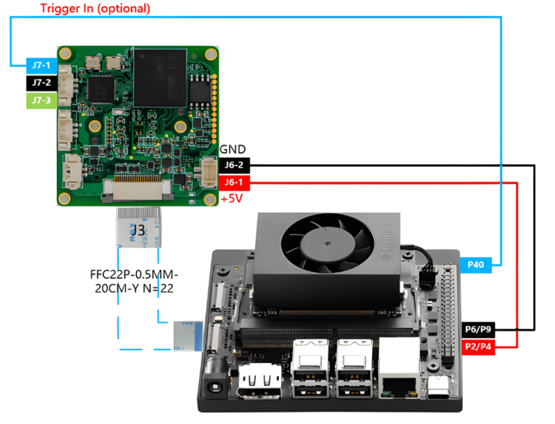

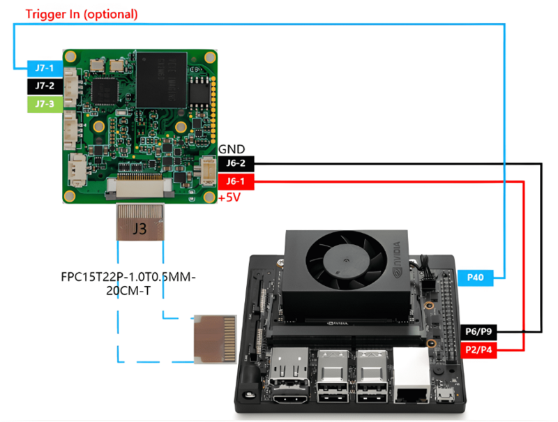

2 Hardware preparation and installation
The GX series cameras require a adapter board to be connected to the Jetson platform. The supported conditions are as shown in the table below:
Camera model Jetson model FFC line Number of cameras Power supply
GX Series Xavier NX 15‑pin to 22‑pin FFC (same-side contacts) 2 5V DC (required)
Orin Nano,Orin NX 22‑pin FFC (opposite-side contacts) 2 5V DC (required)
2.1 GX camera connected to Xavier NX
GX Camera to Xavier NX
2.2 The GX camera is connected to Orin Nano or Orin NX.
GX camera to Orin NX/Nano

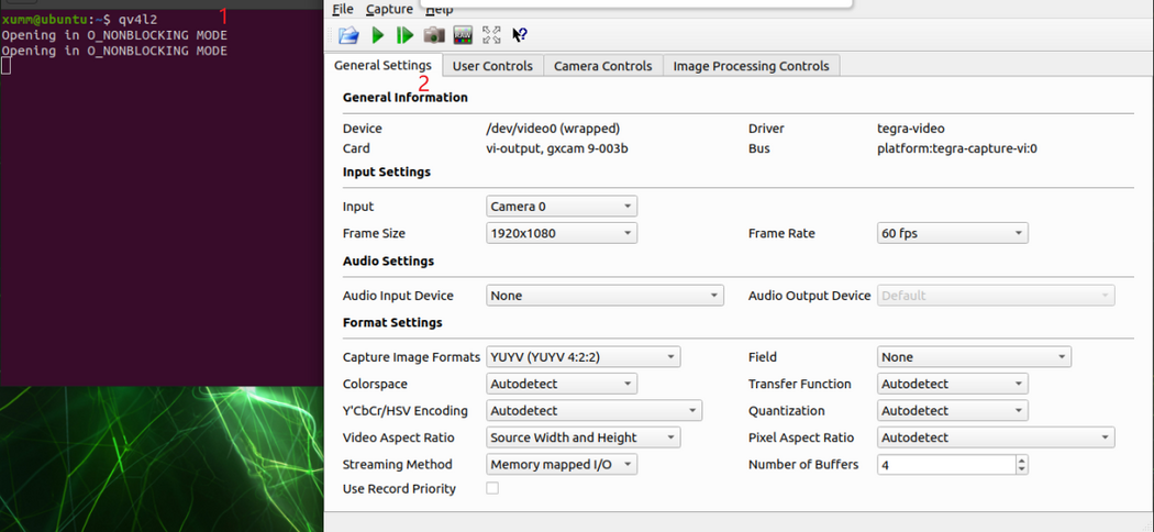

7.2 qv4l2
First, install qv4l2
sudo apt install qv4l2
1. Enter qv4l2 in the command line to start the V4L2 player.
2. Click the ▶ (play) button to bring up the opened media window.
Play gx camera using qv4l2
